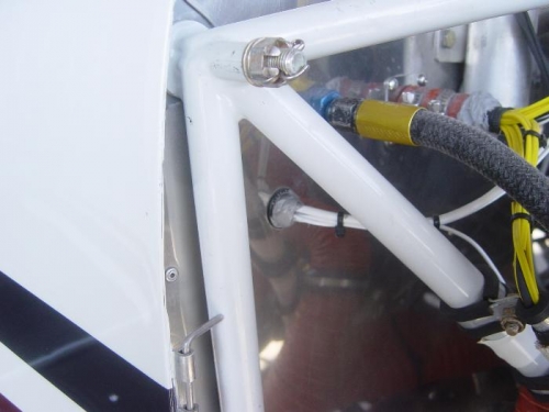

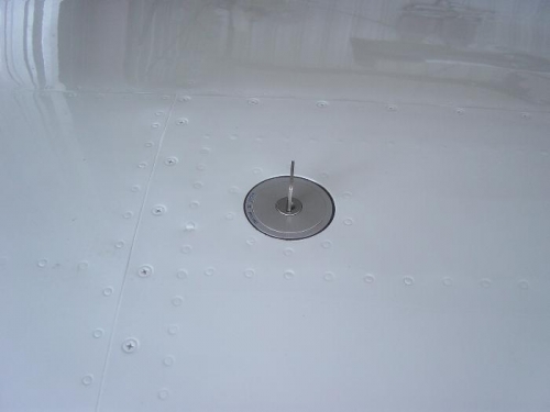

Misc odds and ends. Spent most of the morning on Real estate issues. This afternoon, Replace the screw in the aileron servo arm with one supplied from TruTrak. Then sealed a firewall snap bushing passthrough with some grey RTV. Also sealed some similar snapbushing passthroughs on the aft bulkhead so that the overhead plenum will stay pressurized. Then ProSealed in the locking fuel caps I got from Andair. I checked with the DAR about having them engraved with the USE 100 LL FUEL ONLY markings. He said there was no requirement for an engraving or a plackard. IU've got a set of decals that have those markings, but they are large and surround the fuel cap, and i'm not decided to use them. I'll probably go ahead and have them engraved anyway. Got a letter from the FAA acknowledging the receipt of my medical application.
ProSealed new Andair locking fuel caps
RTV'd snap bushing passthrough on firewall
RTV'd snap bushings on aft bulkhead
