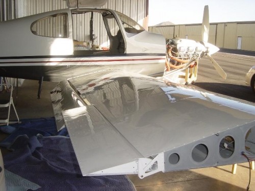

Right aileron and flap attached and rigged

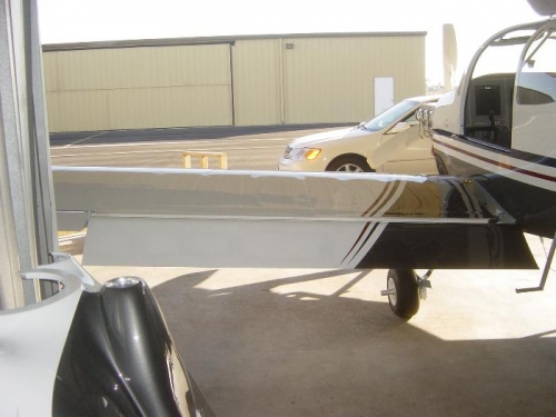

Left side also
Left side also

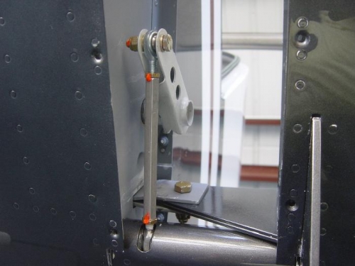

Flap control arm llinkage to flap
