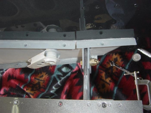

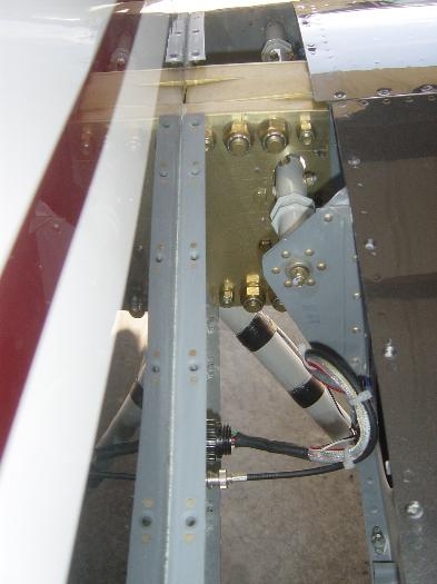

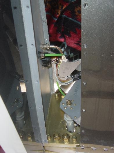

I only had a couple of hours @ the airport today becaus ei've got a bunch of cub scouts coming over this afternoon for a session on tools and to build a simple set of shelves for each of them. So today I torqued all of the wing attach bolts to the proper torque values, Then attached the cannon plugs and antenna and pitot/static connections. I also installed the An 6 bolts and castle not/cotterkey's on the aft spars. I connected the fuel lines from each wing. The remaining connections ar to connect the control sticks to the torque tubes. There are also 2 AN4-14 bolts that need to be installed on the left wing root.
