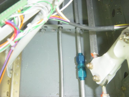

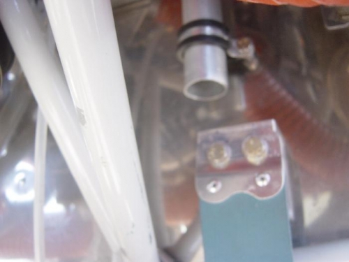

I picked up some flexible hose from Ace to connect to the lower portion of the breather tube...... BUT...... there's not enough room to make a bend and to clear the exhaust hanger bracket. After talking it theough with Jerry and Mickey, I think I'm going to reverse the adel clamp on the lower poertion of the tube, that should move it over to clear the exhaust, I'll also probably make a bracket so that I can mount the adel clamp higher on the tube. I'll get a new tube and reinstall . I need to move the breather tube Up 1/2" so that I can better clear the motor mount and the oil filter. I finished connecting the TCW power optimizer for the Primary EFIS, so I can keep it running during engine start. I may also add an oil pressure annunciator light. so I can start without having the EFIS powered up. I remade the fuel line from under the right seat out to the wing tank, as I found a kink in the old line. Then I installed the fuel & brake capture brackets under each seat to tie down the fuel and brake lines. Next step is to install the cenbter console and it's switches and th autopilot.
Clamp on breather tube rubs on engine mount
bottom of breather too close to exhaust hanger bracket
Brake & Fuel line capture brackets pilot side.
