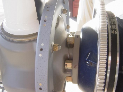

Properly torqued (60 ft lbs) and safetied prop bolts
