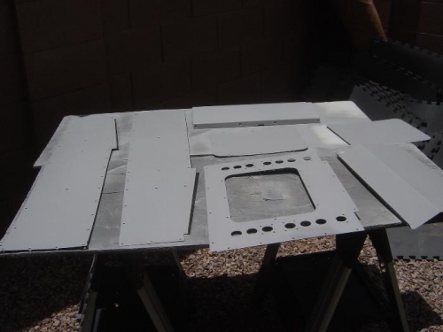

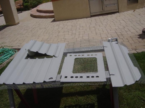

Not a lot to do while the plane is at the painters. Actually that's really a GOOD thing as we're in the middle of the Arizona summer now. But I do have some misc items that can be addressed occasionally. The interior close-out panels have been primed but not painted. Most of these panels will be covered in some type of upholstery/interior covering, but there will be some portions that will be visible, so today was a good time, as the summer monsoon backed off and the air dried out a bit. I also had a little body/repair work to do on the upper aft baggage bulkhead where I had over trimmed for the Ohead console and spliced/riveted in a piece of alum to fix. I filled the joint with bodyy/filler and sanded smooth. took a scotchbrite pad to all of the primed surfaces and then wiped them down with a tack rag. gace them 3 coats of the Sherwin williams Ultra interior paint, and left them to obake in the sunn for the rest of the day.
Aft Baggage bulkheads and seat pan
Misc side panels & seat pan
