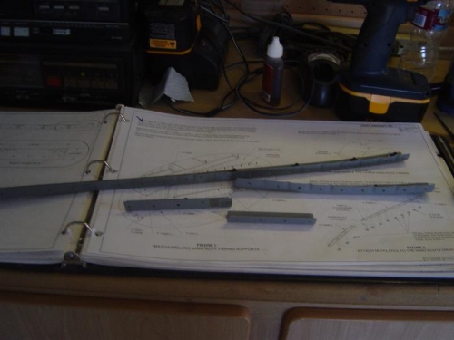

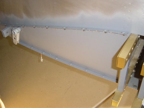

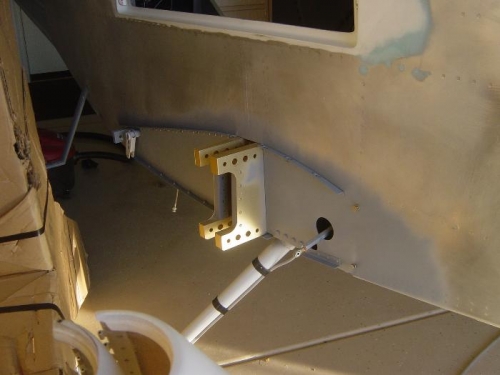

Yesterday and today was spent finishing up items assoc w/ the Right wing install. there were several nutplates that needed to be added to the forward "D" section if the inboard furl tank. And Those were riveted on with the wings in the cradle. The final step was to prime the root fairing support brackect and the fuse side skins and attach nutplates to the brackets and then rivet them on to the fuse. Again a combo os CS4-4, LP4-3's and AN470 4-4&5's. Tomorrow, I'm going to remount the wing tips and the ailerons to insure I've got enough clearance considering the filling I did with the wing tips. and then the wings are ready for paint.
Right wing root fairing support brackets w/ nutplates attached
Fairing support brackets riveted to fuse
Main suppport bracket
