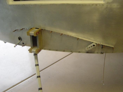

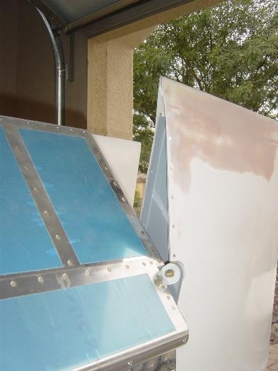

I mounted the filler valve for the Aerox O2 system on the center upright post in the aft baggage area bulkhead. Also reconfigured the battery cables to allow for a cleaner set-up and to allow for access with the cable routed under the O2 mounting base. On Wed. I retreived the wings from the Hangar, hard to believe they've been out there for 17 months!!!!!. I found the wing fairing supports (last of the alum parts!) and separted them, deburred, then fluted them to match the wing contour. Clecoed. and match drilled etc.to both L & Right sides. When loading the wings @ the airport, I 'dinged' one of the flaps because the UHAUL rear door wasn't al the way up. @$#%#@!! I used the hand seamer today and was able to get it worked out pretty well, It's on the bottom of the right flap and won't be visible, but with a little primer/filler. it should be completely hidden. I needed to replace the closeout tips in the wing tips. I had initially riveted them too far aft which caused the fiberglass to spread too far and it caused the wing skins to expand in order to get them installed. So I drilled out the old rivets, and used the dremel cutoff to remove old parts. I had installed the previous parts so that they were flush with the fiberglass, for appearance, sake, but I was having difficulty getting the part at the right position in order to allow for the wing tip to fit without spreading the skins, and so I installed the replacement parts the 'ugly' way !!!!
Wings retreived from Hangar
Replaced wing tip closeout parts to allow for better fit to wing
Wing root fairing supports prepped for install
