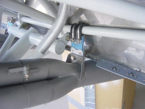

Trying to close up some loose ends today, It's too hot to tackle anything major. replaced the Exhaust hangers with the ones that John Forsling sent. These have a metal bracket that attaches to the exhaust end. John requested I replace the old ones with these. Also at his request I mounted them with just a slight bit of tension on them, rather than with some slack as I had previously done. I completed all of the Throttle Prop and Mixture linkage control rod end connections. And then made a quick run to Aerozona for some large #4 cable fitings so that I could mount and connect the current limiter for the Main elec system. The Auxcurrent limiter gets mounted closer to the battery, aft of the baggage bulkhead.
New exhaust hangers mounted
Metal tabs riveted to strap on end that connects to exhaust
