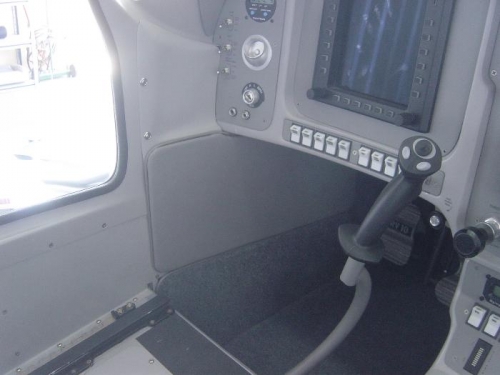

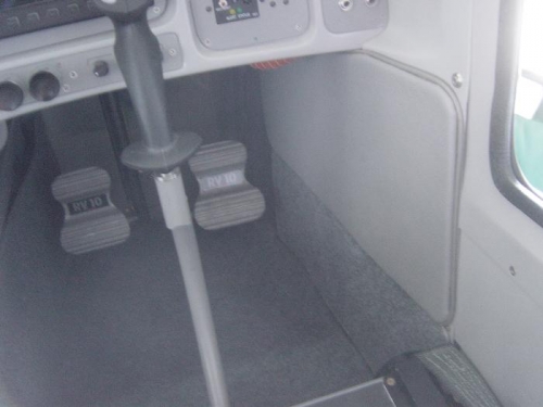

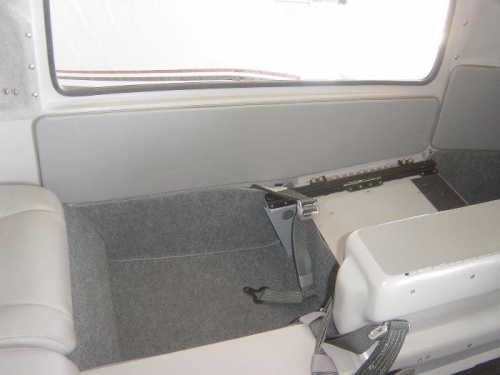

Started out today hitching a ride in Bill Korolick' 7A for a flight with 3 other RV 7's down to CHD for some breakfast. Bill let me fly both ways, TO & Landings. What a Guy! THANKS BILL !!!! I owe you. Once back at the hangar, I jumped back on the interior side panels, yesterday I played around and got a pattern for the left side, only to find out that my lether wasn't long enough, so I've divided the side panel into 3 pieces. 1. Footwell, 2, Doorwell, and 3. Rear seat. I'm using some chip board with some thin foam glued to it. I'm using some spray adhesive that I got from the Fabric discount store, That's is similar to Sticky Stuff From ACS, only 1/2 price. I'm also using the same edge binding that I used for the carpets to bind the upholstery panels. I tried super glue, but it didn't hold, so I'm reverting to Monkey Snot (aka PlioBond) contact cement, which seems to be working fine. insttalle dthem all with the last bit of my Velcro. I finished the 2 front footwell panels, and the pilot side door panel. tomorrow , the Copilot side panel, and then the rear seats.
Pilot side footwell upholstery panel
Copilot footwell upholstery panel
Pilotside door well panel
