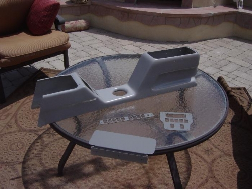

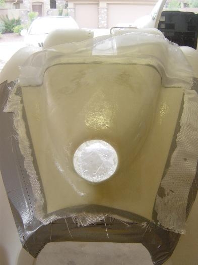

Painted most of the interior parts (except for door window and edges) with Sherwin Williams Ultra Interior paint. This is the paint that I had color matched to the seat upholstery. Items painted, center console and it's coverpanel for autopilot and switches, Center console map box lid 9I'll probably upholster this). Center cabin suport brace/strut. Pilot/co-pilot control sticks, and one of the instrument panel swithc plate that needed some touch-up/. Very happy with the way the paint is turning out. Tpaed of the cowl Ram air mod with some duct tape. then applied a LIBERAL amount of release agent to the area, and proceeded to wettout a 2 ply lay-up, of the modified area. I'l send this to Rod to oohelp any others who might have the James cowl and need/want to use his Ram air system.

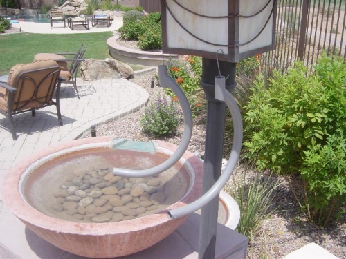

Painted parts 'curing' in 100+ Arizona heat

Mold lay-up of Ram air mod
