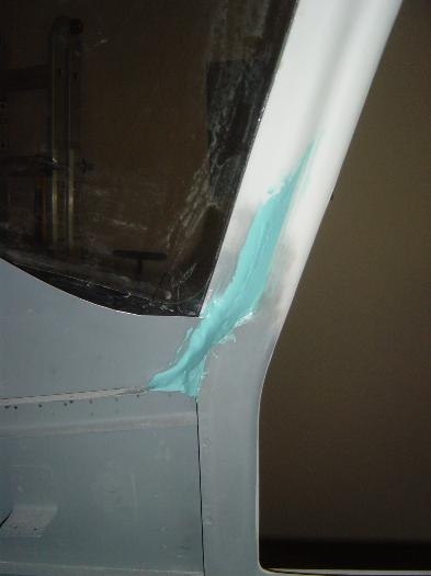

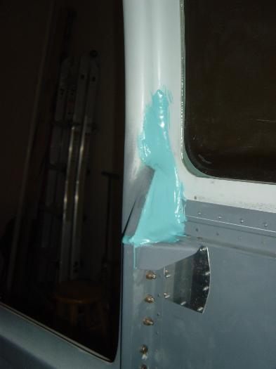

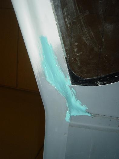

Spent the early part of the day filling the upper portion of the intercostal channels that attach to the fore and aft door jams. I sanded/filed the forward upright to put a ronuded corner on it. then I packed them full of SuperFil. I took several applications as the area is so large the mixture begins to sag. Fortunately the heat helped to accelerate the cure and it began to set up, allowing for another application. I'll let them all cure overnigth and see if any additional aplication sare required tomorrow.
Right forward upright
Left forward upright
Right Rear
Right Rear
