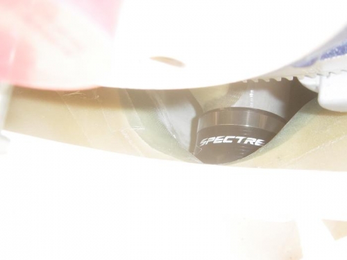

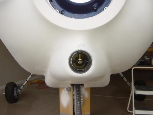

I repaired the damage to the Smooth prime that chipped off when I removed the mold I made for Rod. I also reversed the face of the control arm on the Ram Air canister to provide a little more clearance with the control arm and the cowl side. Torqued all of the control linkage. I still may need to figure out how to put some sort of a limit 'stop' so that the butterfly only opend 90 degreed, currently it's opening about 100 degrees. I replaced the 'flanged' SPECTRE sleve I had previously with a straigth 3" sleve. I had to trim about 1/4" off the length, but this seems to do a good job of coupling the induction ring to the Ram air canister.
Cowling primer chips repaired
Control arm reversed and repositioned
Coupling to induction ring in place
