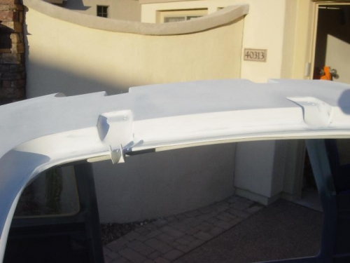

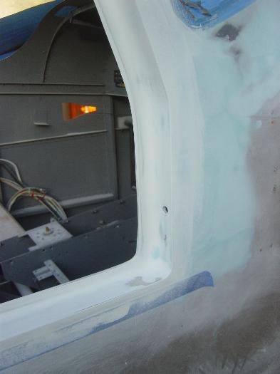

More of the same today. Began this am by pinhole finning the top fwd sectin of the cabin cover. Same method as before two coats of Smooth Prime squeeging in between with a credit card and letting dry in between coats. Best pinhole method I've seem. Then shifted to priming the door jams. I put 2-3 coats on the door jams using a sponge 'brush' it's not perfect but I didn't want to use a sprayer in the initial coats. I've got the right door to the point where I can now spray some light coats on using the sprayer and then final sand using 220 -320 grit. At least that's the plan. just before shutting down today I tried 2 different versions of 'DIY spray cans from the hardware store but both were junk. So back to the compressor and the touchup gun tomorrow.
Fwd Cabin cover pniholes filled and primed
Right door jam progressing
