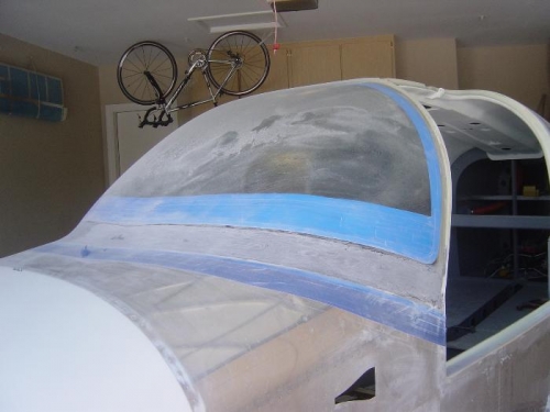

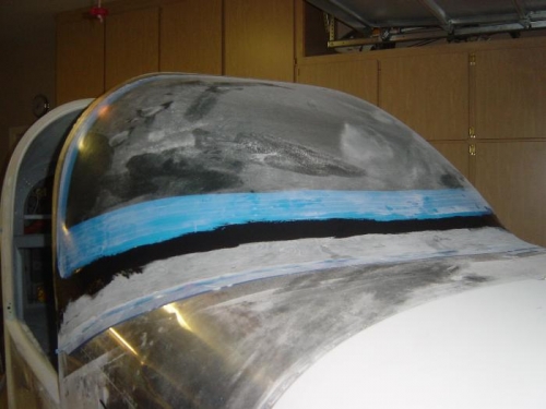

The fun continues ! Finished sanding/countouring the Windscreen fairing, I needed to buy another rasp because the fiberglass dulls these things soooo quickly, but it was worth it not having to expand all of the equivalent energy on sandpaper. I used the Blocking 1" hard rubber tube wraped in 40 grit to sand after the Rasp. Got a uniform and consistent shape. Sanded the upper bow of the windscreen/cabin top and layed up 1 ply of 3 oz cloth between plastic sheets, then cut 2 strips 45 " long and 1 1/2 " wide and layed them up over the plexiglass to cabin top seam. Prior to this I mixed some flox and filled any depressions as well as the holes I drilled for the 'fingers's to hold the windscreen in place while curing. I pullled the fineline tape on the windscreen bottom as it had gotten eaten up a little by the sanding, and I put new fineline tape down. then mixed up some epoxy and cabosil along with some toner Black and painted this on at the top edge of the windscreen fairing. I want there to be as crisp a black edge visible from inside the cockpit as possible. I don't know how opaque it will be after sanding down to blend/feather in tomorrow, but it's better than nothing. and should work fairly well.
Windscreen fairing sanded/contoured
Fiberglass tape applied to windscreen/cabin cover seam
Thick Black epoxy applied to upper fairing .
