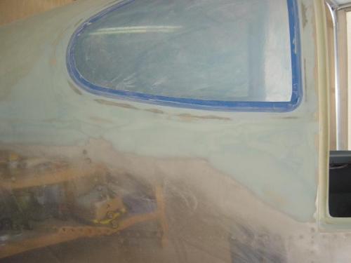

Another -10 builder, Gary Speceter advised me about a product called Evercoat METAL GLAZE, i picked some up yesterday. this stuff is a thinned body filler, that is specially formulated for Aluminum and fiberglass, as such t makes a perfect toot to use to fill the joints between the cabin top and the fuse side and aft skins. It also adheres to some plastics, so I tested it around the right rear window in a section to see if it would fill the area between the fiberglass lay-up and the fine line tape. IT worked perfectly! so I'm using it to blend the fiberglas tapes that I applied to the windows. I'm pretty happy with how this works, it is catalyzed and sets up to sand w/i 30 minutes and that make it much easier to work with. Because it 'flowable' it is also very easy to apply very thin coats and to feather edges, etc. I Also picked up some "BLOCKING' sanding blocks. They are a very hard high density foam rubber block (I got 3 different sizes) that you wrap your sand paper around and while they 'give' a little they also provide a firm even sanding base. It looks like they are working pretty well so far. I'm going to prime the entire cabin cover w/ SmoothPrime after I've finished all of the filling/blending work. I'll use the spary paint ducting them to see how 'even' it's turning out. etting this cabin cover, windscreen, and doors preped is going to take several days!!!!!!!
Right rear seat ven removed and window filled/blended
Right Rear portion of Cabin cover filled/sanded
