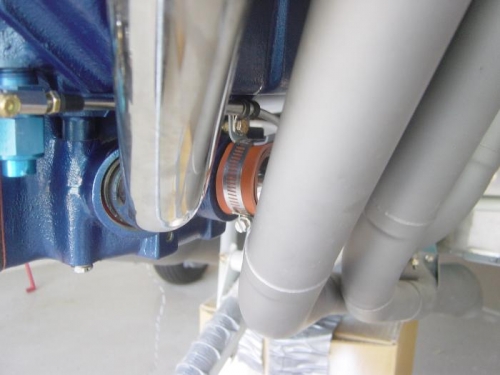

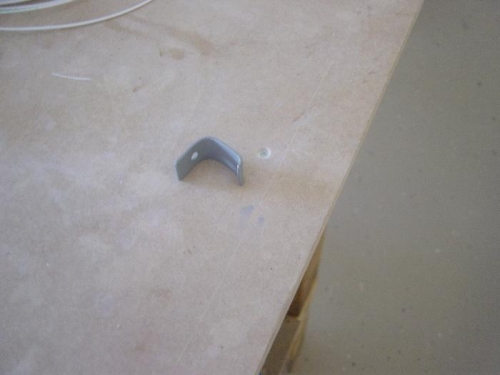

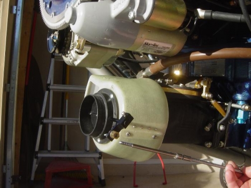

One step forward, one step back today. I got the Throttle cable installed, turned out to not be that big of an issue: I remembered something in the plans about fabbing a clamp for a hose, and decided to make a version of it to clamp the throttle cable to one of the induction tubes. The 1st version of the bracket included a nutplate, but it set too high and interferred with the bottom of the oil sump. So I remade the angle bracket w/o the nutplate and drilled a #12 hole for an AN3 bolt and nut. I also bent the end up so that the ss expandable clamp around the induction tube won't vibrate/slip off. I picked up some rubber gasket material from ACE and warped the inside of the ss expansion clamp with it. I reversed the Throttle arm and that allows for the proper operation of the throttle (i.e. PUSH opens/full and PULL closes). I got a 1" alum spacer from ACE and it works perfectly, I need to pick up the right length AN3 bolt tomorrow. Started to install the Fuel purge valve, but UNFORTUNATELY I found that the cable was 11" too long, I had used weedwacker line to measure, but it was before I had all the other 'stuff' installed, and the 'stuff' has changed the routing. So... A Call to ACS and special order a 63" button lock control cable (4 weeks). Then on to the Filtered/Ram air. Tried various orientations of the canister, also "reclocked" the control lever to the left side, which will allow for the best operation. Th egood news, I can use the old Fuel purge cable for this! I will need to extend the length of the butterfly arm to allow for a full 3" of travel to equal the control cable throw.
Simple bracket to attach Adel clamp for Throttle cable to induction tube
Throttle cable, clamped to induction tube
Experimenting with control linkage options for Filtered/Ram air
