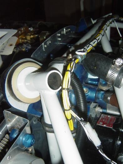

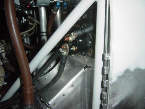

Lot of odds and ends today. Began by installing a 2 lead molex connector for the Oil Temp prob. then I rearranged the EGT & CHT probe harness and the sparkplug leads on the Left side. I installed seperate Adel clamps for the EGT/CHT probes and oriented both harnesses so there's no rubbing/chafing. Replaced a DG 12 clamp on the rigth side with a DG11 for a tighter fit. Used some ty wraps to make a loam and tied off the Right lower plug leads at the rear of the #6 baffle so they are secure and don't rub. Added an adel clamp to the front of the sump to clamp the metered fuel line as it rounds the corner. I replaced the safety wire on the alternator boss mount per recommendations from John Cox . Began to connect starter and Alternators. I ran to the welding supply and picked up more #2 & #4 welding cable. Picked up some terminals from Aerozona. Ran the main starter cable (#2) from the batteries through the firewall and soledred a terminal and attached it to the starter contactor. Soldered 2 terminals to one end of the #2 & #4 cables and connected them to the Starter contactor. I fashioned some mounting brackets to attach the starter/alt cables to sump bolts. Also reattached the tension rod on the right lower (head) baffle)
Added Adle clamp to metered fuel line
Molex connector to connect Oil Temp probe
Starter contactor w/ cables attached
