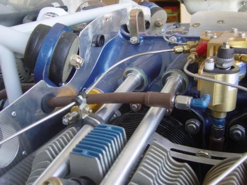

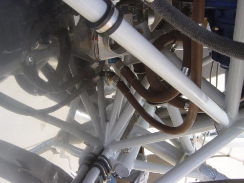

Finished the last of the Fule hoses. While preparing the # 5 Baffle for final riveting, I drilled a hole for the fuel purge valve return line. I put a rubber grommet into the hole and then threaded the fuel return line through it. Mounted the # 5 engine baffle, and then attached the return line to the purge valve and to the firewall fitting which runs back into the right fuel tank.
Metered Fuel hose coming from FM300 fuel controller
Fuel purge/return line routed through # 5 baffle grommet
Fuel return line attached to firewall
