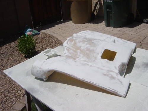

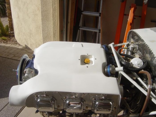

Number of Hours:  5.50
Manual Reference:  Sec FF2-plenum11
Brief Description:  Sec FF2 plenum step 11
Finished prepiong the plenum for paint, # coats of Smooth Prime, followed by sanding, in between each coat. eventually finishing w/ 330 grit. Not a lot to discuss here. I did FINALLY learn that in order to get the Smooth Prime to spray properly and not clog the gun, it needs to be thinned pertty well, way beyond the dilution recommended on the container, almost to a watery consistency. With it so hot, it was pretty eay to shoot that way as it dried pretty quickly.
Sanded w/ 100 grit after initial coat of Primer
Sanded w/ 150 grit after second coat
final sanded w/ 220 and then 330 grit.
