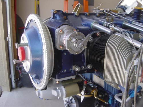

I mounted the prop governor and the starter today. I had to install the studs into the case and wasn't sure about it, the end that goes/threads in easily is NOT the end that goes into the case. Called Allen @ BPE and he straightened me out the stud that has the flat end gets inserted, these threads are a bit finer and thread in a bit tighter than the other end, put a dab og Blue locktite on the ends. I didn't have the right nuts and lock washers, so had to make a trip to Aerozona. whole thing took longer than it should have, but I didn't want to screw up any studs/threads.
PCU 5000 prop governor and Sky Tec starter mounted
