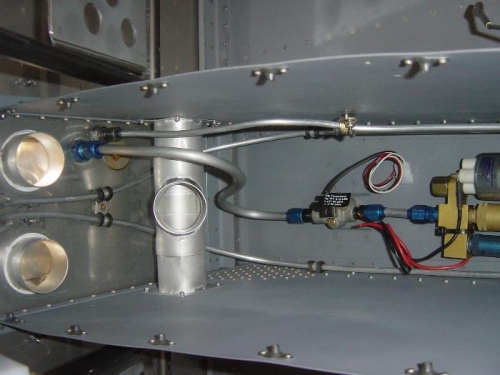

I received the Probes and Sensors from Op Tech on Fri. so today, I mounted the Flo Scan fuel flow sensor. I also ordered some closed cell split rubber foaam insulation to place over all of the 3/8" fuel lines inside the tunnel. This should help keep them insulated from any 'Tunnel heat' and minimize any potential for vapor lock. Mounted the Oil Pressure sensor and the fule pressure sensor to the firewall manifold and attached the VA 133 hose. Since I've got hoses w/ integral firesleeving, the outside diameter is larger than Van's stock hoses. So I need to pick up some larger Adel Clamps tomorrow morning. I ran the Bowden cables from inside the cockpit to the heater boxes, but didn't connect then yet.
FloScan fuel flo sensor installed and connected to fuel system

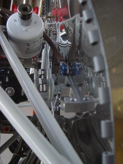

Oil and fuel pressure sensors mounted

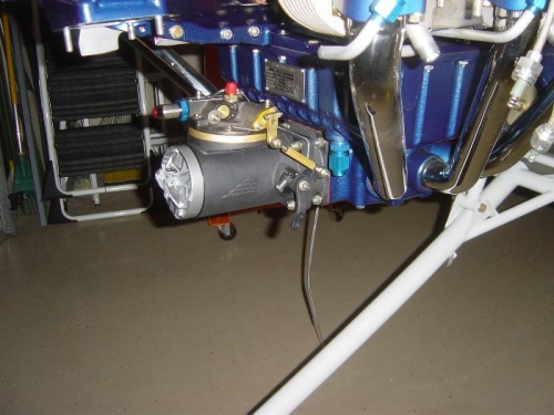

AFP FM300 Fuel/Air controller mounted.
