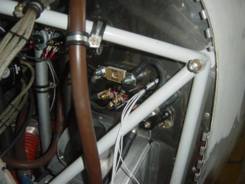

Been down with a cold the past couple of days, beginning to get back to normal. Also stunned by the news of Dan Lloyds death. Makes one want to be as careful as possible and not to rush with these 'finishing' details. I repacked my AeroComposite prop for shipping for service. Wayne Eggerton had an issue with his prop blades sticking. They put out an advisory notice to avoid ops in high temps. Unfortunately that's not an option in AZ. A call to Aero Comp resulted in them having me return the prop to remachine the molded poly parts on the blades to provide a better clearance and allow for the heat & expansion. Great customer service ! All on their nickle. Fortunately I have enough time that this should not hold up progress. Meanwhile back to wiring the panel. I rerouted the Starter Engaged LED lead to the other side of the firewall. I connected the Fuel pump to the switch, the clock to the Batt Buss, and connected the Main, Aux, and Crossfeed contactors to their respective switches. Still remaining: wire the Crossbow AHRS to the panel, Connect the Dynon D10A harness. connect Nav & tail lights. Pitot and static for D10A. and then install and connect center console.
Main,Aux,and Crossfeed contactors wired to stitches
Rerouted Started Engeged LED to this side of firewall
