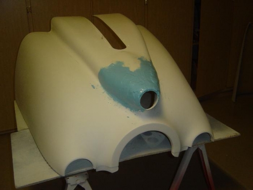

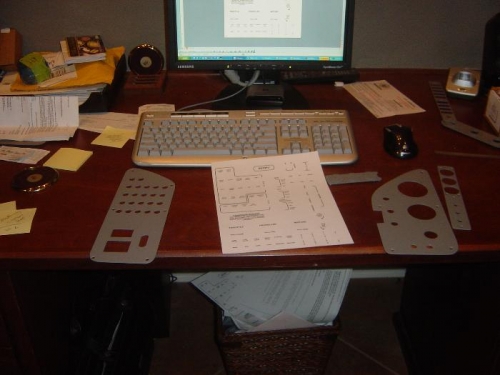

Spent the biggest portion of today (and some of yesterday) drafting the panel graphics in MS Visio. It's a reall series of back and forth trial and error fittings, but I think I finally got all of the lettering and graphics done. The final test was to print them all on an overhead slide, and place them on top of the actual subpanels they will go on. They look all right tonight, I'll double check tomorrow. I found a local guy who will make/burn my silkscreen, and I found out I can get the ink color matched ($60!). So hopepfully tomorrow, I'll drop off the positive for burning and Tues or Wed make a trip into town to order the ink. I decided that the 'lines' on the cowl ram air mod were not optimal, and so I added several layers of Super Fil tonight to let it cure for sanding to final tomorrow.
Laying out graphics for silkscreen
SuperFil buildup of Ram air intake
