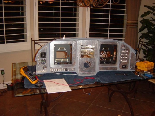

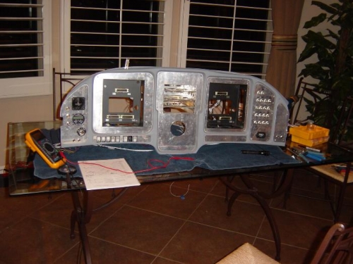

Date:  9-18-2006
Number of Hours:  3.25
Manual Reference:  Finish EFIS wiring
Brief Description:  Finished up the RS 232 connections to the EFIS & M
Finished up wiring the last of the RS 232 connections to both the EFIS and the MFD, needed to run out and get a little more shielded 3 conductor and some 4 plug Molex connectors. Go those done and cleaned up some wiring runs. Then ran continuity checks on all of the EFIS/MFD connections to the various devices they connect to. Found one problem with pin put in wrong location, good thing I checked. Tomorrow, I'll connect all of the grounds to a temp grounding point and then put some power to the panel and begin the configuration/checkouot process (Hopefully, if I don't blow something up 1st!))
