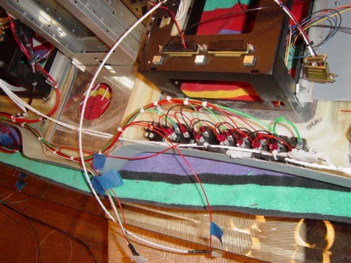

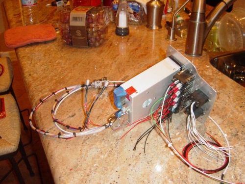

Date:  9-16-2006
Number of Hours:  3.50
Manual Reference:  Switches & pwr
Brief Description:  Switch and light power wiring
Another day of head scratching, I find hat with the airframe I spend 1 out of 10 hours doing research/planning etc. With wiring, it's just the opposite, I spend 10 hours of planning/designing/reasearch, double checking for each hour of actual labor expended, makes the whole process go much slower as I'm logging pretty much actual labor time vs the total. I ran power from the circuit breakers to all of the rocker switches, also ran power to the lights on the rockere switches in the console. The switches in the panel all go to things external to the panel and will get connected to their respective devices when the panel gets mounted in the airframe. I need to connect the switches in the console to the devices they control (and put a disconnect between) and then I should be ready for a continuity check of all connections and following that a power on test of the avionics. I've been puzzeling over the connections to the rocker switches, I can 'make' the fast-on terminals 'work' with some coaxing, but I'm uncomfortable, so I'll go ahead and test it this way, but I'll either order some terminals from Stein and solder some wire with 'real' faston terminals to the switches or attempt to find some quick connect terminals that can be crimped and attach directly to the .110 terminals.
Only thing left here is to connect the switches to their devices
