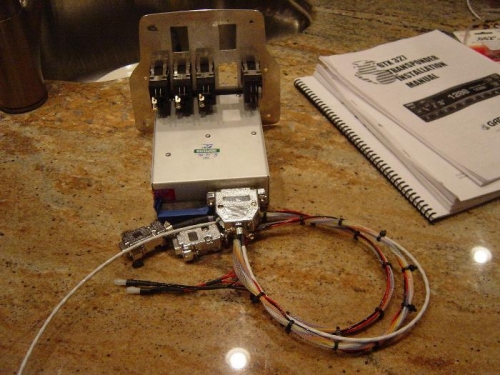

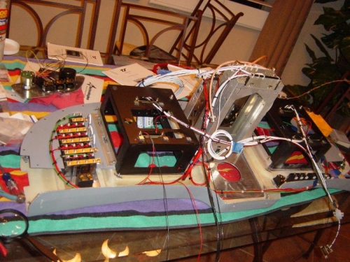

Brief Description:  Autopilot harness and power distribution
Fabricated the Autopilot harness to connect to: power, servo's and EFIS. Assembled the circuit breakers and bussed then together into Main and Aux using brass bus 'bars'. then attached the power wiring to each breaker for the respective device. Next step is to connect the power to the respective switches. Then to run the wires for the Fused power circuits. Also need to make the connection to the EFIS for the autopilot.
Circuit breakers bussed together
Autopilot harness
Autopilot harness
power distribution from circuit breakers.
