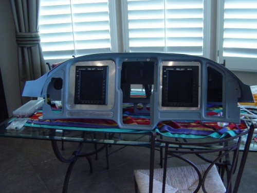

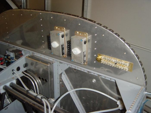

Mounted the voltage regulators, forest of Grounding tabs, and primary ANL to the firewall, while its still easy to get to. Needed to make some adjustments to the Co Pilot EFIS so that the slip indicator is level w/ the pilot EFIS. I needed to redo the mount to make this work there is still a minor difference, but hard to tell whether it's the pilot or co pilot that's off. I'll wait til the upper fuse is riveted to the rest of the fuse to make the final adjustments. Then I forced myself to begin on the panel wiring. I've been completely intimidated by this, for fear of ruining some very expensive electronics, coupled with my lack of knowledge of the same. It's pretty easy to follow the wiring diagramd regarding pinouts and harnesses. However with a complete glass/electric panel w/ electronic back-up there is a TON of wiring, The challenge is how to get the wiring ORGANIZED so that it's not a complete Spaghetti bowl behing the panel, and that it can be maintained and allow for removal and reinstallation of components. I'm also embarrassed at just how much time it takes to strip, crimp, pin, heatshrink, etc. I'm well on the way to having most of the center stack wired (340 audio, 327 trnsp, SL30 & SL40). I need to finish this up and then work on the connections to the EFIS/MFD and EFIS/MFD to AHRS.EIS,ADC. Look slike i'll be at this for a while. The good news is that I'm doing it indoors and avoiding the AZ heat!!!
Both Voltage reg's  & grounding tabls mounted

EFIS/MFD remounted
EFIS/MFD remounted
