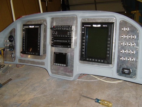

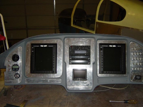

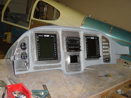

Manual Reference:  Panel-5
Brief Description:  Mounting of Dynon D10A back-up EFIS
Changes out the 8 screws in the upper two trays that were interfering with the install of th audio panel and the Transponder. Then mounted the Dynon D10A back-up EFIS. (I need to make an adjustment to get it level) I have also decided that I'll mount the Digiflight ll VSGS autopilot on the top of the stack, I checked and there's room for it there, that left a little more uncluttered room @ the bottom of the stack so I didn't have to jam the Dynon down close to the ThrottleProp/Mixture controls. The only thngs left to physically mount are 1. Autopilot 2. Pitch and rool trim indicators (will go on either side of the Dynon) 3. The 1 1/4 " airvents from Stein. 4. Headphone jacks. 5. 12v Aux power receptical 6. Pilot & co-pilot headphone jacks. 7. Switches 8. TPM controls and heating vent cables. 9. Remote Waas GPS sensor. Time to now start to figure our the wiring runs and harnesses !!!!!!
Most of the major avionics physically mounted
Need to get the Dynon to sit level
A different view
A different view
