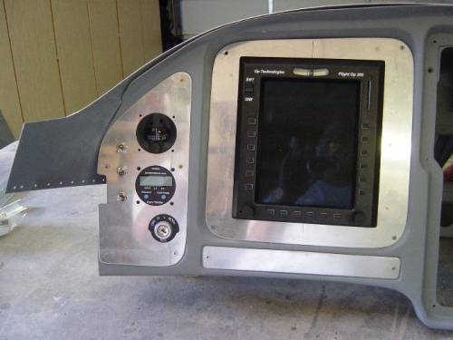

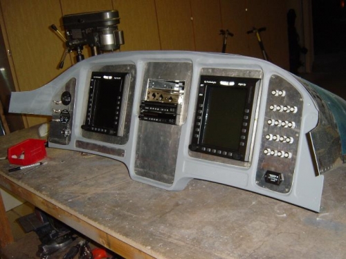

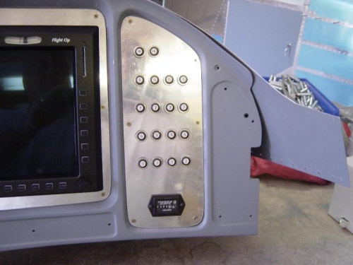

Finished up the side panels I had to cut out the mounting panel on the pilot side to make room, and then creat a hole for the compass to pass through. Also mounted the HOBBS meter. Then on to the center stack, I wanted to mount everything as high as possible, the limitation is the center rib. Even with the modification I made to strengthen it and to make more room, There is still a restriction, The SL 30 & SL40 are over 11" long, so they went at the bottom of the stack. I've been nervous as heck about this whole panel thing. Mostly because I can't have the panel inserts cut by CNC/water jet, so I'm having to do it all by hand, and The panel is one of the things that really needs to look nice, as that's what I'm going to be looking at most of the time while flying. I'm finding that with some careful filing that it's going pretty well. I'm taking a LOT more time than on the plans sections, hope its all worth it. Tomorrow I'll mount the Dynon back-up EFIS. The DigiFlight ll VSGV is on order from Stein. It will go directly below the radios and above the Dynon. The Throttle, Prop & Mixture will be mounted at the bottom .
Pilot side panel installed
Hobbs Meter installed on breaker panel
Center stack installed. mounting screws interfer on top two bays
