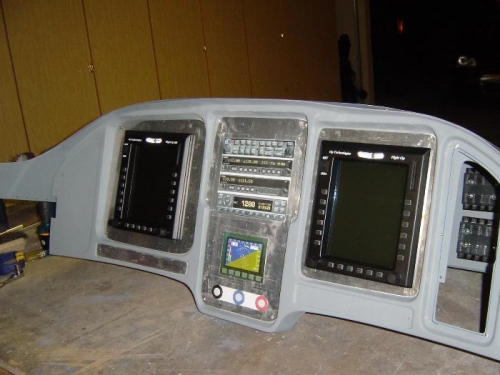

Brief Description:  Physically mount the EFIS & MFD
Began this am by widening the sub=panel cutout. It turns out that I centered it on ethe center rib, but that's NOt the center of the panel center stack, so I widened the left side 3/4". No I'll be able to mount the radios centered. The rest of the day was spent physically mounting the EFIS & MFD. Because Of the way I've mounted the panel, this turned out to be a bigger job than expected (so what's new?) This whole panel and console are costing me BIG in the way of extra time on the project. I miss marking off pages in the plans and seeing daily progress. The slip indicators are mounted on the top of each EFIS, right now they are a little off, i'll wait unti i mount this into the airframe to see if I need to make adjustments in the mounts (likely I presume)
the MFD mounting took quite some time
Mouting the EFIS was easier
Both units temporarily installed in their racks.
