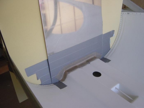

Brief Description:  Sec 43 Overhead console fabricate aft flange

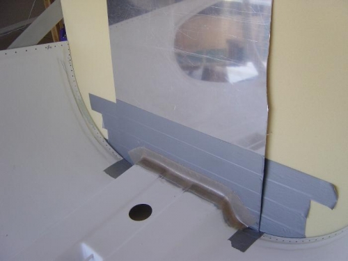

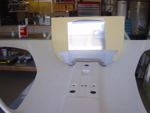

Took the Cabin cover off the fuse for what I hope is the last time. I needed to fabricate a flange to seal off the overhead console from the aft bulkhead, the one that came with the console was too long. Used some Duct tape to tape a piece of 1/4" foam in place to use as a pseudo bulkhead for laying up the fiberglass. than I layed strips of duct tape over a scrap piece of .062 to provide some space and clearnace for a gasket and the aft bulkhead. Then proceeded to lay-up 4 plys of 6oz cloth
Aft overhead console pressur seal flange
Again
Again
And again
And again
