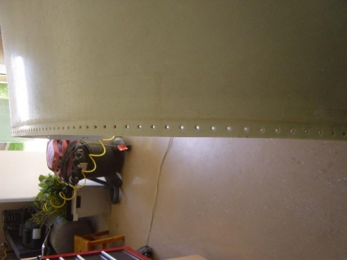

Deburred all of the holes in the back-up strips and countersunk all of the #30 holes that attach the Cabin cover to the Fuse. Deburred and dimpled the Fuse side skins. I made a test piece of .032 dimpled to determine the depth for the countersinks. The plans call for CS4-4's but I wondered if 426 AN4's might be better. i put out a querie to the Matronics RV10 list and it appears that there's no advantage to the 426's . I'm gong to fill and glass this seam anyway, so I'll go with the CS 4-4/s I'm going to need to place an order w/ Van's cause I don't think I've got enough.
Countersunk #30 holes in the Cabin cover

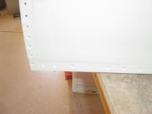

Afte Cabin cover countersunk. you can see that on the right Aft edge the rivets get close to the edge.

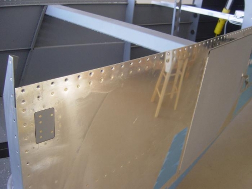

Fuse side skins deburred and dimpled
