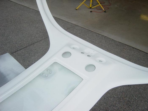

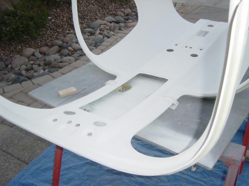

Last day of priming/sanding on the cabin top interior and overhead console. Began this am by sanding everything with 220 grit. It was plain that there were some spots that needed to be built back up with the body filler, so sanded away all of the primer, and rebuilt those few areas. identified a handful of other areas that needed some patching. then sprayed another 3 coats of UV smooth prime on (only this time LIGHTER coats). then finished off everything with a final sanding fo 330 grit. I'm pretty happy with how it turned out. when the primer is wet, you can still see some 'waves' in a few of the places. So it could be better, butt considering that 90% of this will be covered by a fabric headliner. I think that it will do nicely. Now Tomorrows task is to fabricate some fiberglass window retainer rings that I'll wrap with headliner and use to finish off the windows and headliner for a nice finished look. This Sat. is Copperstate and a bunch of RV-10 guys! Bill Derouchy is bringing his newly painted -10 over from Watsonville CA. Can't wait to see it & him.

Before
Before
After
After
