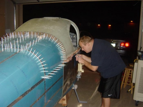

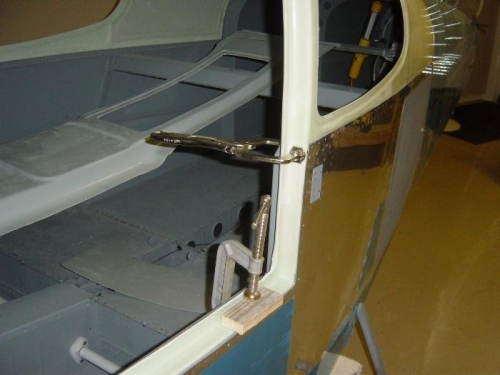

Was sick on Mon (UGH!) Took Tues to clean up the back yard, renovate the lawn and plant the winter rye in time for Torey's wedding reception next month. Tony Sustares overhead console arrived Tues and I unpacked it today, looks like it should be a fairly straight forward install. Put the Cabin cover back on the fuse , several times actually, prepratory to match drilling it to the fuse skins. I needed to file/sand more fiberglass away from the front door posts where they meet the upper forawrd fuse. I also filed some of the outside edge of the F1042 off in order to get a better fit. Took about 4x on and off then clamped per plans and match drilled all of the #30 holes after clecoing in the F1074 top skin. Parker came out and was a bit bored so I showed him how to do Clecos; and he had fun following me drilling and him plugging copper clecos!
Clamped per plans
Clamped per plans

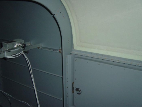

The afte egde of the cabin top is short as it meets the bulkhead at the longeron. Many builders same
Parker the Cleco Man!
