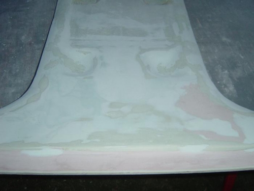

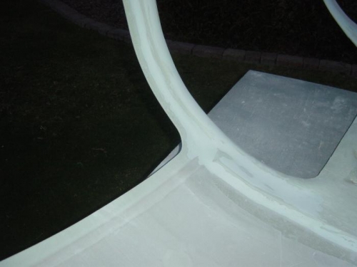

After throwing this tpoic (of filler suitability) open to the Matronics board and some off-line discussions. I decided to press ahead and continue with the auto filler for the remainder of the interior of the cabin. The rationale is: a. removing it would take more time than a future potential repair, and based upon it's being an interior product and the filler is essentially being applied in thin layers the liklihood of cracks developing are mitigated. So, I'll pick up some 'aircraft grade' filler for the exterior when that comes time. Nothing remarkable except that it takes a LOT of time, sand, fill, sand & fill, But I am much happier with the contours and finish than I would have been without any filler. I've got most of the visible cabin interior surfaces prepped. It will probably take 1 more day of the same to finish it off. I decided today to order the overhead console and fresh-air system from Tony Sustare # Accuracy Avionics. It includes fresh air swivel vents, switches, map lights and more. I'm still debating on air conditioning but if I install this now it will make a subsequent a/c install a little easier if I decide later on..
not much to show for hours of sanding and filling
sand 7 fill, sand.....

..... and fill,,,,,,,
