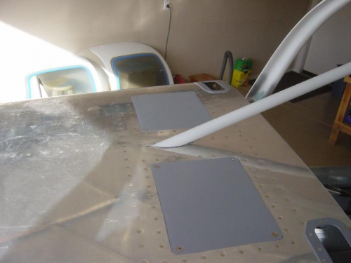

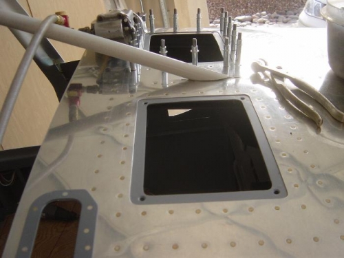

Finished installing the accss panels to the upper fwd fuse. When I receive the parts I will mount some 80mm computer fans into each panel for avionics cooling and defrost. I was happy with being able to get a fairly tight/close fit on the panels and the fuse. I made a doubler out of .062, installed some #8 countersunk nutplates in each corner, then riveted the assembly to the previous cutout. 4 # 8 screws seems to hold the access panel flush. It took the whole day to get this finished,
Seems like a long time, but I had to remake the access panels as I got too agr3essive on the corners and didn't like the gap that it created. Another step closer to getting the windscreen installed.

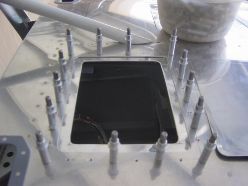

Match drilling for the doublers
Riveting the doublers in place
All done and buttoned up!
