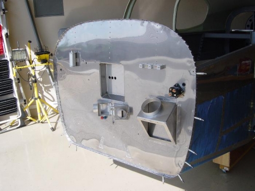

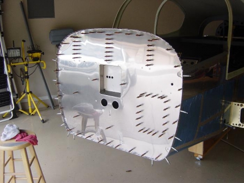

Began today by applying glue to the Fiberfrax on the faux f/w and the orig f/w. Then clecoed them together and riveted the faux f/w. Assembled/riveted the Oil cooler mounting box and then riveted it to the f/w. reinstalled the heater vent control boxes. I also created a 'gasket out of fiberfrax and installed it between the heater control vents and the faux fw. So there is double insulation between the control boxes and the inside f/w. Attached the Starter contactor, temporarily installed the brake res. and installed the oil/fuel pressure sender mount. Gave the f/w another polish just for grins. Need to figure out where everything will be mounted on the f/w and get it done before the upper fwd fuse gets reinstalled.
Faux firewal glued and clecoed to orig fw

Faux firewall riveted and misc f/w items installed
