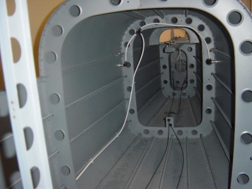

The goal today was to accomplish 3 items, 1. Install pitch servo, 2. Re-install flap position system, 3. install/connect static tubing & ports. 2 out of 3 ain't bad. I discovered that I also have the bracket that doesn't align with the installation platform, rather than cobble together a work-around I e-mailed Andrew @ Tru-Trak and asked him to send a corrected bracket. On to the Flap position system. the 1st system had a problem in the control moodule, and I returned it. This one went in and worked just fine. Then the dreaded task of cllimbing back into the tailcone and connecting the Safeair static tubing and plumbing. It's 105 in the garage and who knows how hot in the tailcone, but with jufy holding the flashlight and running tools in and out, I got things connected pretty quickly.I've been thinking about interior and seats, I think I'm going to go with the Clasic Aero seats, anyway i pulled out the pilots seat and set it in place and climbed in for the 'hey look I'm building an airplane photo' I've resisted up to this point, but with the panel mocked up, I wanted to see how the console, stick and panel 'felt' ............. felt gooooooooood!!!!!!!

Static ports conected and plumbed
