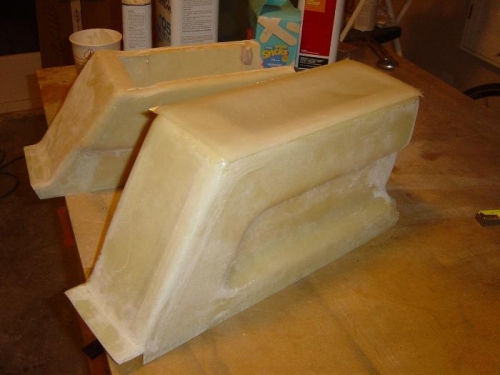

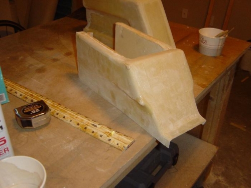

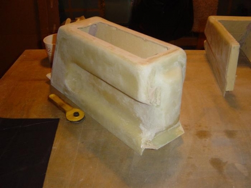

Cleaned-up the 2 console pieces by trimming and hand filing/sanding. There are a couple of places (corners) where the glass got a little thin so I dug those out w/ the dremel and filled them w/ flox, I'll file/sand them tomorrow. I also need to add another 8 ply lay-up to the top of the armrest/mapbox suficient to allow for a cover to be installed. Let that all cure tonight and i'll try and pick up some lightweight sandable filler tomorrow from the auto paint shop. Need to fabricate the middle section which surrounds the Fuel valve selector handle and then join the 3 pieces together.
Filed sanded and patched w/ flox
Filed/sanded floxed/microed a few places
Added 8 ply lay-up to the top of armrest console.
