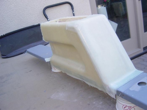

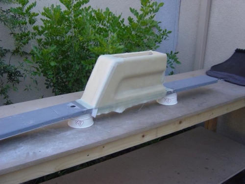

Fiberglassed the armrest portion of the center console. I did all 8 plys rather then 4 + 4. IT worked Ok except at the rear of the console where the double/triple compound curves were too much for the cloth to take. I'll sand it smooth and then put some smaller lay-ups over that area.
Left side AOK
Left side AOK
You can see a 'pucker' at the bottom of the phone jack pad on the rear
Right side AOK
Right side AOK
