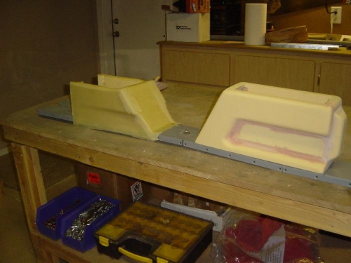

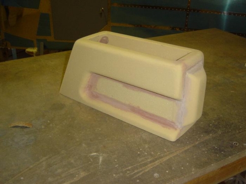

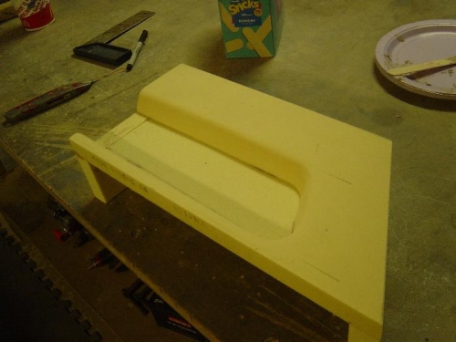

Constructed the foam core/mold for the mapbox/armrest portion of the center console (Console #3) Used Bondo instead of 5 min epoxy to join the individual foam pieces, seemd to work much better (sets up faster). Basially I'm copying the design of the Lancair console. Nothing complicated just a lot of measuring cutting, sanding/fitting, sanding/fitting sanding/fitting. Picked up some additional fiberglass cloth today, should be able to get this piece glassed tomorrow.
