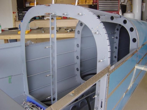

Finished off the baggage section. Primed and riveted the Right baggage cover. Match drilled the Upper and Lower baggage bulkhead corregations. Drilled same for nutplates. riveted nutplates, Installed wear blocks on the baggage bulkhead corregations primed them and installed on fuse.
Right baggage panel/cover going in.

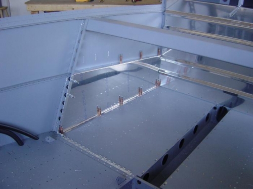

K1000-8 Nutplates clecoed and drilled

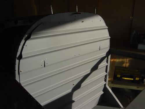

Baggage bulkhead corregations installed.
