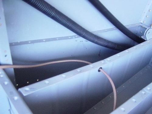

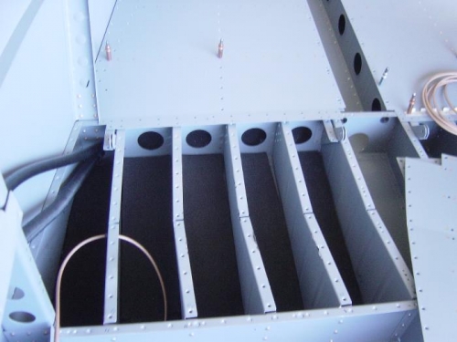

Finished gluing down the soundproofing material (sticky stuff) for the rear seat rib wells. Drilled access holes for the RG400 COAX, and put a service loop in. The drilled access holes in the Seat pan for the elect conduits and the antenna coax, installed the rear seats under the baggage floors and finished riveting them LP4-3's mostly
hole to get antenna cable to side panel
Soundproofing glues down

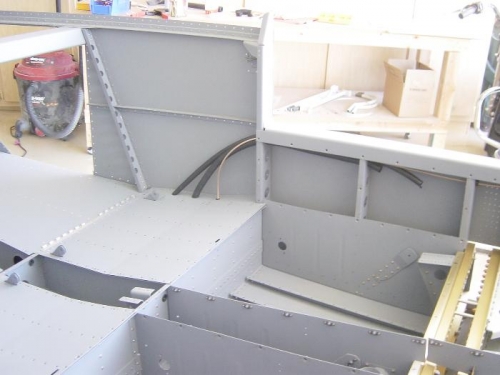

Rear seat pans riveted. Shows elec conduit and ant cable
