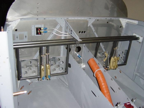

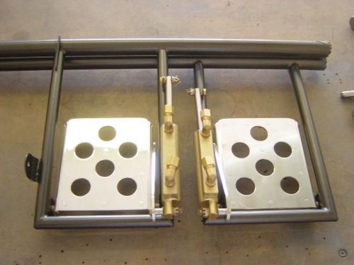

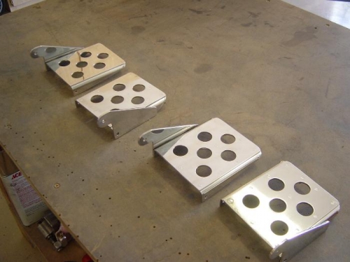

I decided to polish the brake pedals. don't know if this was a good idea or not. Time will tell. but for now they look AWESOME! IT took 3 hours (partly learning curve using the polish and wheels). Then mounted the pedals to the rudder arms, and mounted the brake cylinders, got everything secured using castleated nuts and keys, Then drilled the mounting bearing blocks, and mounted the bearing block mounting plates to the longerons. Final step was to slip on the bearing blocks on each end and bolt them to the mounting plates/longerons. Need to add the center support (tomorrow) and the brake lines and fluid reservoir.
polished the brake pedals. WOW!
Mounted to rudder bars and brake cylinders
Whole shebang mounted to fuse!
