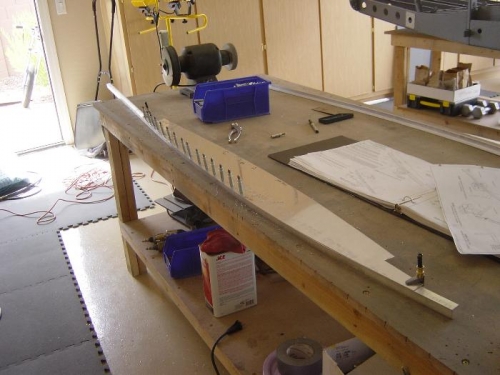

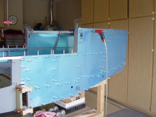

Back to the Fuselage Side Skins, however, before digin in I had some REQORK to do, I messed up the F1013 L longeron and had to remake it, I also had a similar problem as Mike Sausenm in that my F1015A outboard seat ribs were not position correctly (they were on th eoutside of the F1004D, meaning that I had to drill all of the AN3 rivets off of the bottom skin on each side to get them free enough so that they could be repositioned correctly to fit inside of the F1004D supports.After that it was mainly a job of clecoing on the Mid Fuse Side Skins and match drilling both sides.
