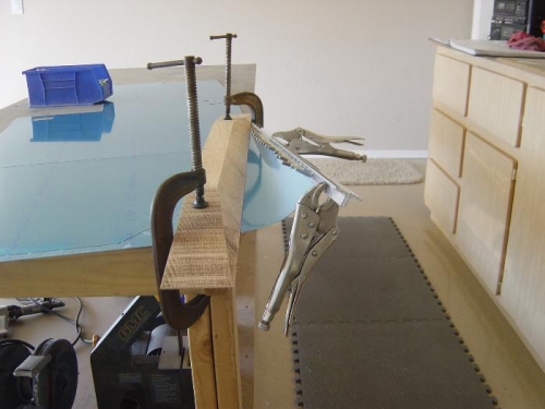

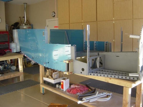

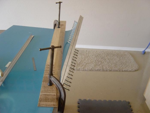

Bent the Aft Fuse skins both L&R. The plans don't say anything about bending the Left (but it's just a repeat of the Right, after the confusion with the .063 angle, remade the construction angles out of .125 and the bend went right in. It takes a pretty good twist to get to 60 degrees, and After clecoing on the skins to the fuse it probably could go a little past 60, I added 5 degrees for the Left and that was still a little shy. All in all it went much easier that I had heard, after fretting over the Righs skin, the Left went in in about 30 minutes.This is a rewarding step because the Fuse now has some skins on it and it's beginning to look like it might be an airplane some day!!!!!!!!!
Right Skin bent
Right Skin bent
Left Skin bent
Left Skin bent
