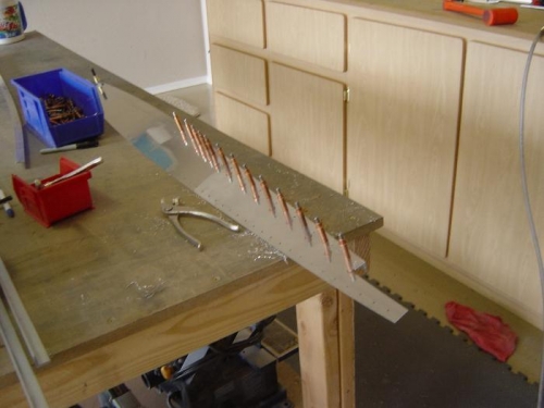

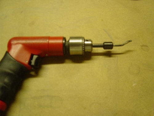

Bent the F1046 L&R longerons, I was worried about this based on experience of others, and it's a little frustrating in that as you get the bend into the angle the angle also takes on a bend in the other axis, so just when you think you've got it matching the template, you have to go back and straighten the other axis, and that causes you to have to rebend the original, but back and forth and eventually everything aligns. I was so proud of my self and then I noticed you need to match drill some #30 using the template as a guide, I mis-read the plans and drilled holes into the R longeron that aer NOT suposed to be there, So an order to Van's and Fed-Ex and I'll be back in business.Then cut to length the F1013 L&R longerons and marked then per plans.Horror of Horrors, my drill dropped and ruined my #30 Cogsdill OUCH!!!!!
Match drilling #30's into F1046L
What will I do now?
What will I do now?
