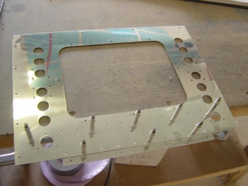

Remade the Seat Floor Angle supports after receiving new material. (I cut the previous ones too short.) Cut the Seat Floors and the attach strips, deburred the edges, match drilled for attach plate and angle, drilled the nutplates holes, scotchbrite and prime, rivet the angle and the attach strip and the nutplates, then set aside .
Countersink the attach rivets

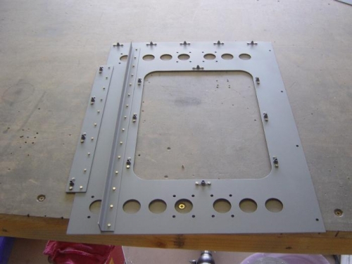

Left seat floor riveted

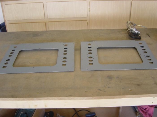

Both done
Both done
