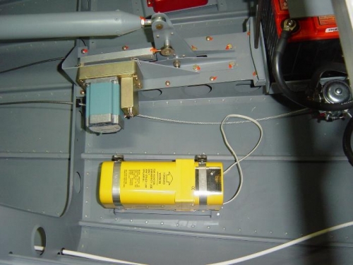

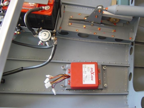

Brief Description:  Mount Strobe power supply and ELT
Fabricated mounting brackets for the Strobe power supply and for the ELT, primed them, Then mounted them to the bottom of the tailcone. should be ready to attach all wiring and pull all wires from the rear of the aircraft forward on Monday. I got the ELT that is driven off of "D" cell batteries, supposedly it's portable, if you sirvive a crash and want to walk out. Again, don't know if this was a good idea or not based on the stats for ELT effectiveness, but it will satisfy the DAR's requirements.
Strobe power supply going in
Bracket for ELT
Bracket for ELT
ELT installed
ELT installed
